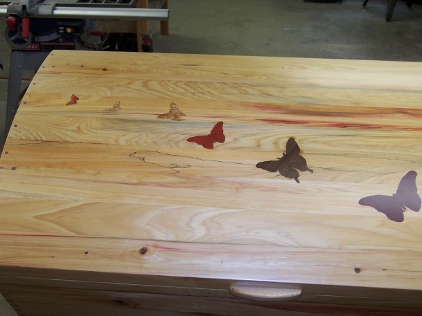

Colby, if it's small I would use a jewelers saw, just as in cutting pearl. Ebony isn't that hard to cut. On larger pieces I use my scroll saw with a spiral blade that lets you cut in any direction without having to turn the wood so much. I cut all these butterflies out on my scroll saw.
I've done ebony butterflies for inlaying on the top of jewelery boxes the same way.

Old Man, how thick are those butterfly inlays? I'm wondering how strong ebony would be when thinned down thin enough to inlay into a top. If it's too fragile it seems it wouldn't hold together for a vine.

Colby, the larger ones are about 3/16" because that chest top has a 30" radius on it. For flat inlays I would probably make them 1/16 to 1/8 depending on how intricate the sawing will be. You can always make it thick and scrape it level. Unless the cut is really complex, though, I think 1/16 to 3/32" could be handled without a problem.
